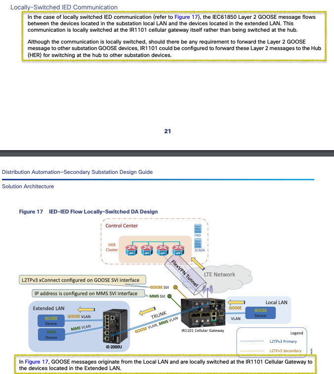

From what I've found, the IR1101 can be configured to forward these Layer-2 GOOSE messages with IEDs.
Source: Distribution Automation—Secondary Substation Design Guide, found here (PDF) and here (online Docs)
