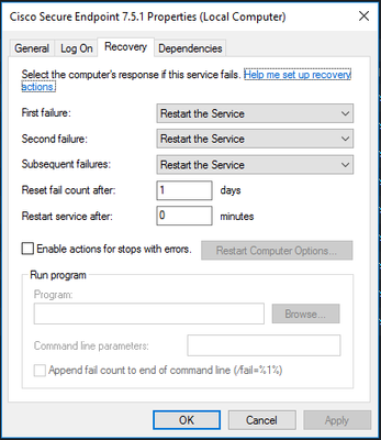

joljol
I would also think the Recovery settings on the service itself would take care of restarting the service if it failed to start? But alas...
Below are the default settings.
I appreciate you bringing that to light. Was this in the user guide? I wonder if you set the "Run Program" to the path of the connector if that would help with keeping that loop from happening of the service not being restarted. Either way, thanks for reporting this!
