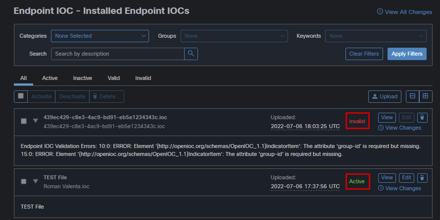

Roman Valenta
Here is my own experience when I was trying to understand on how to built my own IOC's based on TAC case that we received while ago. The issue was with uploading IOC's. So let me share my experience hope this will be helpful to you.
Error Received:
From reviewing the specific error message it looks like the IOC was missing a required attribute “group-id” in the Element “IndicatorItem”.
However, I think this message is bit misleading. I was curious if I can replicate the same and I did. I was not sure what program CU was using at first to write the IOC’s but later found out the were using Open IOC by FireEye
After some test/trial I found the issue is with the app and how it saves the file. I’m not familiar with this app, but I download the copy and just created super simple file for testing purposes when I saved that file and try to upload to my AMP instance I got this same error as you can see above.
I also thought I’m missing some fields, but when I look in to the IOC’s that are already uploaded they don’t have “Group ID” either so I start comparing the code and notice some differences between each other and when I save the code on my PC and try to import it to the FireEye app it was telling me that the code is in old format and if I want to transform in to updated format.
That put me in to idea that there must be something about how the IOC file is formatted. I try manually change few things, but I was still getting errors so I decide to hunt for something that will write IOC in to simple IOC format and I ran across this online tool.
https://www.iocbucket.com/openioceditor#
What I did here is that I created the exact same IOC using the exact same attributes or fields and save it. When I upload this file it worked. Here is couple screenshots that should help.
Here showing the exact same fields between the online editor and OpenIOC by FireEye
This screenshot is showing both IOC’s uploaded where one prints with same error as above and the other was accepted just fine

With the information Roman provided, I tested first with the newer version of OpenIOC 1.1 editor. The issue is with the xml interpreters.
This is taken from the .ioc file created using the new version:
xmlns:xsd="http://www.w3.org/2001/XMLSchema"
xmlns:xsi="http://www.w3.org/2001/XMLSchema-instance" id="953d1903-0adc-41a2-845e-a067cbd2f7f0" last-modified="2023-11-10T15:27:32Z" published-date="0001-01-01T00:00:00"
xmlns="http://openioc.org/schemas/OpenIOC_1.1"
When I looked at your output from the online tool from https://www.iocbucket.com/openioceditor# (URL doesn't work for me), it includes schemas.mandiant.com which I'm guessing contains the "group-id” in the Element “IndicatorItem”.
xmlns:xsd="http://www.w3.org/2001/XMLSchema" id="8885fea4-3f9e-4cf5-9459-dfc99eb2415a" last-modified="2023-11-10T16:41:37"
xmlns="http://schemas.mandiant.com/2010/ioc"
 I downloaded the older version of OpenIOC 1.0 from the fireeye marketplace (https://fireeye.market/apps/238651) and created a basic IOC and was able to successfully import it into Secure Endpoint
A final note:
It appears FireEye has taken over the Mandiant OpenIOC editor since the link in Mandiant's article (https://www.mandiant.com/resources/blog/openioc-basics) takes me to the fireeye marketplace.  For anyone interested, it can be downloaded here: https://fireeye.market/apps/238651
Hope this helps anyone going down this path.
