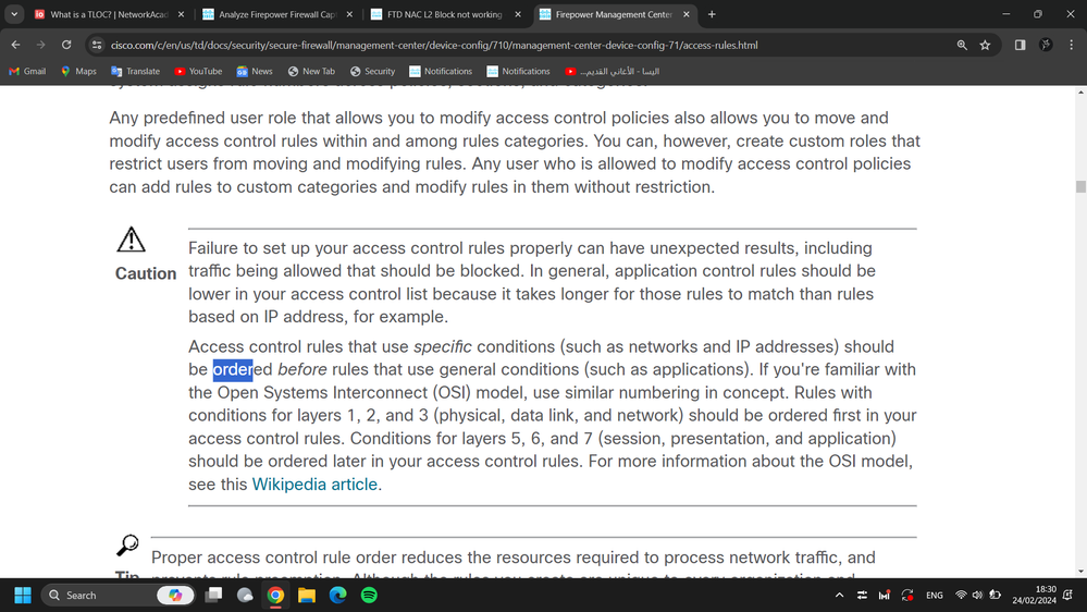

Hi friend
since the APP ACP rule have two ports
one in Lina and other in Snort
the lina part is permit any any
so cisco recommend to put ANY ACP rule for APP in down list
I think here you config it in UP list and it match traffic that must be deny
so remove the ACP APP and add it again in down list
If above not work' try tune the l7 rule by specified the source and destiantion prefix put it in down list before deny ip any any (l3 rule)

@MHM Cisco World , if I understand you correctly. In order to keep the rule as it is configured and still be able to use Packet Tracer, the deny rule for the application protocol needs to moved to the bottom. So basically right before the Deny All statement.
I get what you and @Marius Gunnerud are saying. But this seems to be a flaw of packet tracer then.
Because if I keep the rule as is and move it down to the bottom, a novice admin troubleshooting might still see this in packet tracer as a permit any any and be confused by it.
And "fine tuning" the rule defeats the purpose to deny all source subnets going to all destination subnets, in all zones; from ever being able to use the application protocol in question.
Yes move it to bottom
