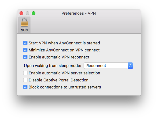

You will need to provision AnyConnect trust store with a CA in the ISE certificate chain or turn off the "Block Connections to Untrusted Servers" setting (not recommended):
