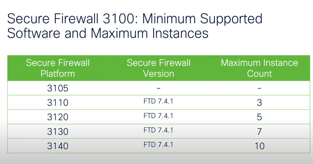

@Marvin Rhoads It seems there's something else I'm missing.
I'm not able to commit the changes after changing to deploy mode container.  I found another forum post where you suggested the sysopt sam 1001 on, and after doing that I see the following messages.  I've included the FXOS version I'm on.  What am I missing here?  These will managed via FMC but according to the documentation multi-instance has to be enabled at the CLI.  The error states to make the configuration within FTD (connect ftd) but there is no multi-instance configuration option in FTD.  I've opened a TAC case, but have not received much help yet.

firepower /system # set deploymode container
firepower /system* # commit-buffer
Warning: Changes not supported. use: 'connect ftd' to make changes.
Error: Update failed: [Multiple Instance feature is not supported in this version.]

I guess I should dig into this version since that is what the error is telling me. It would be suprising if FTD3130s ship with FXOS code that doesn't support multi-instance since that feature has been around for a long time.  I was assuming that error means something else but isn't clear.

Found this on youtube.  So that appears to be my answer as the FTD version these (brand new) 3130s shipped with is 7.2.8.  Frustrating.
Ah there you go. Once you upgrade, you can change the mode.
