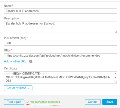

A few question around Cisco Secure Dynamic Attributes Connector (CSDAC).
On a test FMC (v7.4.1), I've enabled the CSDAC integration and added build-in connectors for WebEx, O365 and Zoom, confirmed FMC is receiving feeds and corresponding Dynamic Objects are created.
It looks to be pretty useful for Exchange online and Teams (the dynamic object for Teams is called "o365_Worldwide_Skype"). Haven't tested Azure or AWS connectors  as I have not obtained the API keys from the relevant teams, but from what I've seen on YouTube etc looks pretty cool as we can just use the tags on AWS EC2 instances.
I'm now testing the Genric Text connector and my questions are with 1) feeds format and 2) certificates.
On the Cisco Secure YouTube channel, it is using the Feodo tracker's CnC blocklist as an example and text file is used instead of JSON. Does this mean JSON isn't supported?
I'm using the Zscaler hub IP addresses for our test from here.  https://config.zscaler.com/zscloud.net/hubs.
When I add the URL for the recommended addresses in JAON format ( https://config.zscaler.com/api/zscloud.net/hubs/cidr/json/recommended) and hit the Test button it completes successfully, however, it does not add any dynamic object/s.
Then comes my second question around the certificate. On the tutorial vid, just hitting the Fetch button and the CSDAC fetches the cert automatically, however, on my box I just get the below error as soon as I hit the Fetch button. "Unknown error: module 'lib' has no attribute 'd2i_PKCS7_bio'"
So, I've exported the certificate from the above URL and imported it, but if I hit the test button it the test connection fail.
Can anyone confirm 1) whether JSON is supported or not?
And troubleshooting steps for certificate issue that I'm facing?
Many thanks,
atsukane
Level 3
Level 3
OK, so I figured out about the certificate, I had to use Firefox and download the PEM chain, then the connection test completes successfully   (Export from Edge and Chrome didn't work from me.)
However, JSON format appears to be not supported as no dynamic object added for the Zscaler hub IP via the new generic text connector.
4 Replies 4
atsukane
Level 3
Level 3

Update as I noticed that Zscaler is now hosting the Zscaler Aggregate IP Address Ranges and Zscaler Hub IP address ranges in plain text format.
I've exported the certificate as base 64 chain in PEM format, then imported them in to Generic Text connector.
You the have the Dynamic Objects created. Unfortunately the object names aren't great in this case in this case
