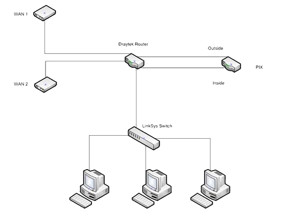

I am experiencing issues at a site where I need to replace an ageing PIX 506e with an ASA 5505.
The current setup looks like this:
The PIX is used for site-to-site VPN connection via the WAN 2 link.  The WAN 1 link is used for general Internet connectivity.
I don't have access to the Draytek Router as it is supported by a 3rd party, but I believe it uses static routing to direct the relevant traffic to/from the PIX.
When I replace the PIX with the ASA, the inside i/f connection experiences dropouts - but no errors show in the logs.
The only significant difference I can see in the config is that the ASA utilises VLans for the inside & outside interface configs - I used the PIX-to-ASA Migration tool to make the initial configuration on the ASA.
In tests, if I only connect the inside i/f of the ASA, pings from the LAN are stable.  Once I connect the outside i/f, pings timeout approx 80% of the time.
Could anyone offer any advice please?

Phil,
I think I know why. The ASA firewall uses the same mac-address for both Vlans, so that can mess the hell up with that router (if it is using switchports). If it is using interfaces it shouldnt cause a problem.
If you do a show interface and look for the mac-addresses of both vlans, you will see what I am talking about.
Based on your diagram, I think that is the problem.
Solution, Assign the physical mac-address of the port that is connected to the outside to the respective vlan ID. You can see the physical mac-address using the show version command.
Let me know how it goes.

Mike, many thanks for this info - I will mark it as correct answer when I get the chance to test (I am out of the country at the moment), but feel very confident that it will solve the issue.
Again, thank you.
Phil
