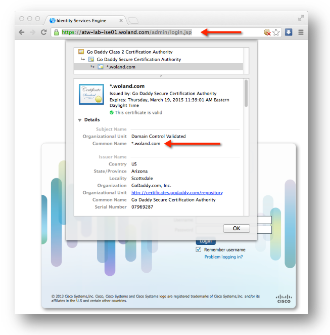

Wildcard Certificates
What is a Wildcard Certificate?
A wildcard certificate is one that uses a wildcard notation (an asterisk and period before the domain name) and allows the certificate to be shared across multiple hosts in an organization. An example CN value for a wildcard certificate’s Subject Name would look like the following: *.securitydemo.net
If you configure a Wildcard Certificate to use *.securitydemo.net, that same certificate may be used to secure any host whose DNS name ends in “.securitydemo.net”, such as:
  • aaa.securitydemo.net
  • psn.securitydemo.net
  • mydevices.securitydemo.net
  • sponsor.securitydemo.net
A wildcard is only valid in the host field of the fully qualified domain name (FQDN). In other words, *.securitydemo.net would not match ise.aaa.securitydemo.net, because the wildcard value was not in the host portion of the FQDN.
Below is an example of using a wildcard certificate to secure a web site (specifically, the web interface of an ISE node). Notice that the URL entered into the browser address bar is “atw-lab-ise01.woland.com”, but the certificate’s common name is “*.woland.com”.
Example Wildcard Certificate
image.png Note: Wildcard certificates secure communications in the same manner as a regular certificate, and requests are processed using the same validation methods.

You must always be careful when deploying wildcard certificates. For example if you create a certificate with *.securitydemo.net and an attacker is able to recover the private key, that attacker can spoof any server in the securitydemo.net domain. Therefore it is considered a best practice to partition the domain space to avoid this type of compromise.
To address this possible issue and to limit the scope of use, wildcard certificates may also be used to secure a specific subdomain of your organization. Just add an asterisk (*) in the subdomain area of the common name where you want to specify the wildcard. For example, if you configure a wildcard certificate for *.ise.securitydemo.net, that same certificate may be used to secure any host who’s dns name ends in “.ise.securitydemo.net”, such as:

Wildcard certificates are most commonly constructed with the wildcard listed as the canonical name (CN) of the subject field of the certificate itself. ISE version 1.2 and newer support this manner of construction, however not all endpoint supplicants will support the wildcard in the subject of the certificate.
All Microsoft native supplicants tested (including Windows Mobile) do not support wildcards in the subject of the certificate. The use of another supplicant, such as Cisco’s AnyConnect Network Access Manager (NAM), will allow the use of wildcard characters in the subject field. Another option is to use special wildcard certificates like DigiCert's Wildcard Plus that is designed to work on incompatible devices by including specific sub-domains in the Subject Alternative Name of the certificate.
For more information on Microsoft’s support of wildcard certificates, see here: http://technet.microsoft.com/en-US/cc730460
