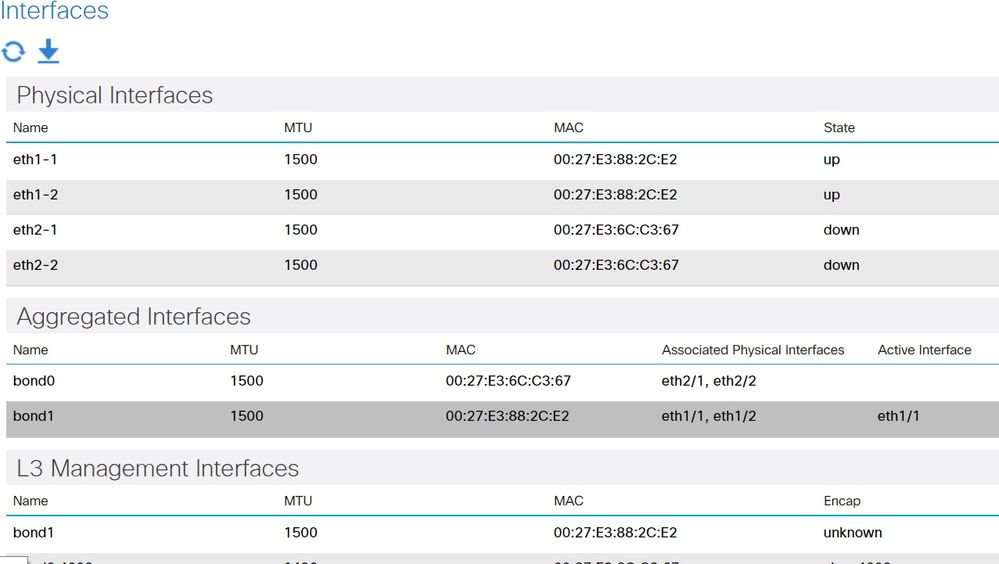

[Update: to phrase my question better, included a screenshot. I only see two NIC. Do I need more? 1/1,1/2,2/1/2/2 ?]

One more thing, looking at the screenshots you posted, it doesn't look like you have connected your APIC to any leaf node since eth2-1 and eth2-2 are showing as down. Eth1-1 and Eth1-2 are both the LOM ports of your APIC which are used for OOB connectivity of the APIC.

"to fabric" ports connected.
is this port supposed be part of In-Band mgmt for clustering?
screenshots attached aftewards (out-of-band mgmt is reachable wihle in-band is trunked with vlan tagging).
Yes the connection of these ports are required to discover the fabric, and for clustering.
