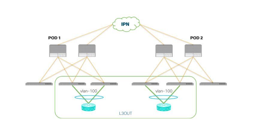

We have been testing this setup L3out for Firewalls with two cisco routers running VRRP and they are unable to communicate with each other over ACI L3out.
Example:
Router1 10.10.10.1 VRRP: 10.10.10.254
Router2 10.10.10.2 VRRP: 10.10.10.254
Pings between routers does not work but both can ping the local leaf and secondary address no the L3out. VRRP remains master on both routers (example Router1 10.10.10.1 unable to ping 10.10.10.2)
We have tested VRRP works out side of ACI.

@Manuel Velasco quick topology picture if it helps

You created a single L3out for both of this routers, correct?
What do you mean by “the leaf can iping each other’s loopback”, what about the SVIs defined the in the L3out logical interfaces?
If the arp table doesn’t have all the entries that explains why communication between the routers is failing.  It might also means that ARP packets are not making it accross the multipod/IPN setup, so I would double check the multicast configuration on the IPN.
Have you verified if the arp packets are making it to the other router?
