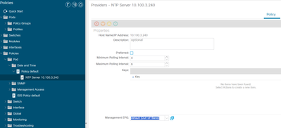

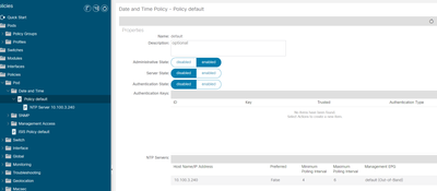

  1. Check NTP Configuration:
    • Log in to the APIC GUI.
    • Navigate to Fabric > Fabric Policies > Policies > Pod > Date and Time > Policy default
    • Verify that the NTP servers are correctly configured.
