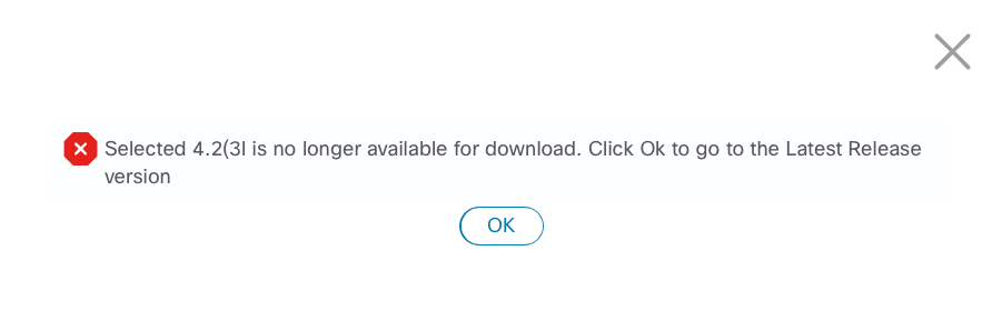

Are you sure you got all the files from the same version? I can't get 4.2(3l) anymore.
RedNectar aka Chris Welsh.
Yes, I downloaded all the file form same version.
I realise now the reason I got the error was that I'd clicked on the link in your post (which is missing the last ")" character)
