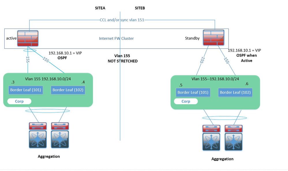

Hi Team,
Like to know what would be the best option to establish a L3 out from ACI Leaf directly to Firewall. Thought of enabling HSRP on the ACI side however due to code versions i am not able to move beyond.
The topology is i have two checkpoint firewalls and i have to connect them to the Leaf switches ( Going to use port-channel between firewall and switch )

To make sure my understanding is correct, vlan 155 is used for sync in the ClusterXL or is this the vlan that you use to setup your peering between the fw and the fabric?
Normally you would create a svi with a specific vlan encapsulation for your routing setup between firewall and the ACI Fabric, this vlan should (not) be stretched depending if you would like to monitor this interface and trigger a failover on the CP when an issue occurs, the firewall is using the sync interface (using multicast or unicast) to synchronise all session (if this option is enabled) and this vlan should be stretched between your DCs.

Hi
Thanks for the info,
Correct me if im wrong though. Our inside interface is in vlan 155 and are all members of the cluster. These interfaces need to have L2 stretched into the DC in order to exchange CCL protocol with each other to maintain the cluster. This is the same L3 interface we will OSPF Peer with ACI.
Or is there an option with ClusterXL to create a new bond and have this as the clustering interface instead of the bond155??
Apologies not a FW guy,
Is the below achievable?
Hey,
I am not a fw guy either 😊, however you should have a separate bond interface just to do your peering with with the ACI fabric (you could use the common tenant to create a shared L3 out),
so your internal interface will keep vlan 155 and will have l2 adjacency with the standby checkpoint and your sync / peering interface will need as well (obviously) l2 adjacency with the backup CP.
As you mentioned the CCP (checkpoint control protocol) will send packets on its interface to verify if it can reach its peer interface (I think the lowest vlan is chosen if you have a bond interface) and failover
will occur if no ccp messages are seen (this can be disabled though for specific interfaces).
