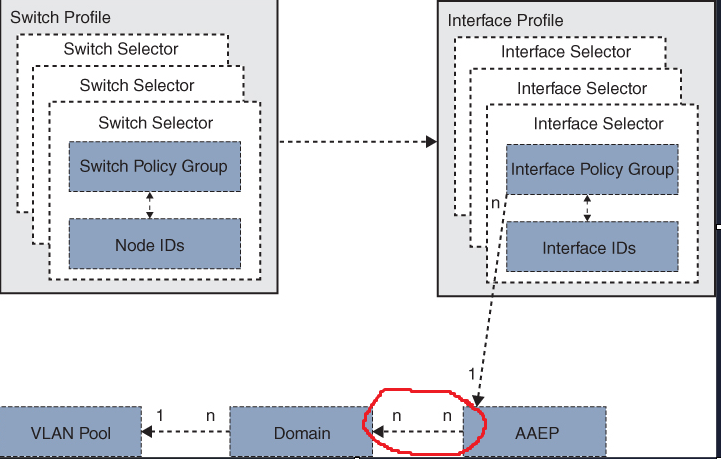

I am studying for the DCACI 300-620 through the book and I came across with this:
Can't a Domain reference only a single AAEP? I can't add AAEPs to my single domain in my ACI 5.2(7g).
EDIT: I also came across with this:
Domains can be used in more than one EPG, for example I can use the same VMM Domain in two different EPGs.

Hi @BertiniB ,
You've never been able to add AAEPs to Domains EXCEPT at the time of creation! (You can't remove an AAEP from a Domain, or change the AAEP via the Domain configuration either)
But you've ALWAYS been allowed to add/remove Domains to/from AAEPs
So the many-to-many relationship is correct.

Re the 2nd diagram.  It is wrong.  Your statement is correct. Send feedback to the authors of the diagram

Thanks @RedNectar for the reply. What I understood from the diagram is that it is possible to associate multiple AAEPs to the same Domain, but it doesn`t seem possible

BertiniB
So is it a many-to-many or a one-to-many relationship between AAEPs and Domains? Seems like one-to-many: an AAEP can have multiple domains, but a domain can have only one AAEP.

It's actually a bit more complicated than that - will add more if I get time.  But essentially it is a many-to-many, but whomever wrote the user interface only implemented the configuration from the AAEP side.  Don't know why - one of my bug-bears

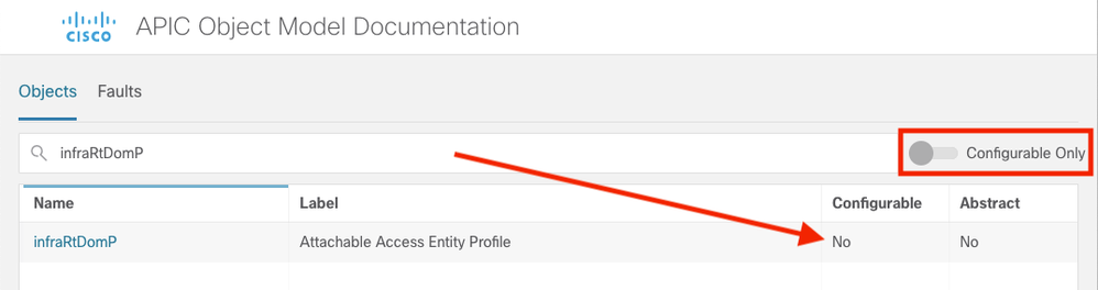

Hi @BertiniB ,
It's more like "another relationship gets created" rather than "you have to create..." Even if you are using the APIs, you don't need to worry about the fact that these object exist. If you look at the APIC Object Model docs https://your_apic_ip/model-doc/#/objects/  and search for infraRtDomP you'll see that it is NOT a configurable object.
