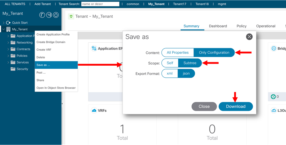

Step 1 is to take a snapshot of the existing configuration in case this doesn't work.
Step 2 is is to save your Tenant configuration as a JSON or XML file. Make sure you choose Only Configuration and Subtree
Step 3 is to edit the file you just downloaded and replace all instances of SR_PRD with PRD_VRF (or whatever your new name is) and the save the file.
Step 4 is to delete your tenant. Yes. You read that correctly.
Step 5 is to right-click on a tenant in the list of All Tenants and choose Post
Step 6 Make sure you enter uni/ as the Parent DN, select your edited file and Post.
Step 7 Make sure nothing's broken
Step 8 Roll back to the snapshot you saved before you started if it is broken - then back to Step 2
I hope this helps.
