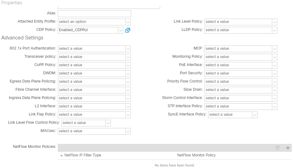

I have this topology:
spine101 port 17 <-> leaf131 port 36
(yes, it's dual-spine with more leafs that this, I just want to focus here on this link unless I need to consider the larger topology)
The link is functioning fine if I do nothing.  I'm trying to enable CDP on that link.  Spine seems to have CDP working with a Spine Interface Selector policy. Leaf is a 9336-FX2, I'm running 5.2(6).
With the below Leaf Access Port Policy Group, I get the error "Fault delegate: Configuration failed due to invalid-card,invalid-port for uni/infra/accportprof-Leaf131_IntProf/hports-P36-typ-range for node Leaf131"
Any suggestions?
