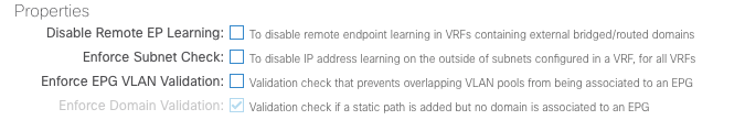

Firstly, @robert is not EXACTLY right when he says:
"Enforce Domain Validation" feature under the System Settings - Fabric Wide Settings - Enforce EPG VLAN Validation (previously called Domain Validation)
because it is STILL called Enforce Domain Validation - AND there is a DIFFERENT option to Enforce EPG VLAN Validation.
So, @glezJos91986 - the feature that you really need is indeed the Enforce Domain Validation - NOT the Enforce EPG VLAN Validation.
Secondly, you need to understand that IF you have taken APIC Fabric backups or snapshots BEFORE you flick the ACI Enforce Domain Validation option on, you will NOT be able to restore them once the option has been toggled. This is because once it's turned on, you can't turn it off. And if you were to restore a Fabric backup, it would be attempting to turn the switch off.
And thridly, and this is really cosmetic - I want to make sure you know about the best App you can add to ACI - it's called the Policy Viewer - and when installed, you can look at your EPGs and see the whole Tenant AND Access Policy Chain - but ONLY after the EPG has been linked to the Domain. It is just AWESOME.

Thank you so much Chris for the aclaration/explanation and pictures.
