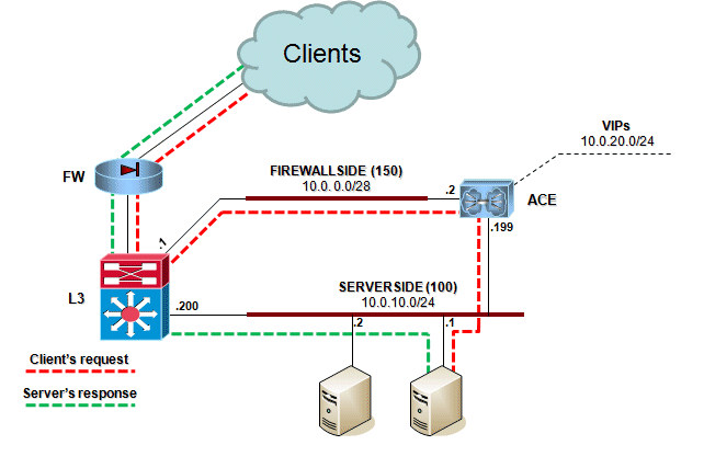

Topology example:http://3.bp.blogspot.com/_Tdhn-HYCK18/SKGWUzrw0gI/AAAAAAAAAjk/2wR4mjAOn3g/s1600/ASN-simple.gif
http://snippets101.blogspot.in/2008/08/asymmetric-server-normalization-on.html
