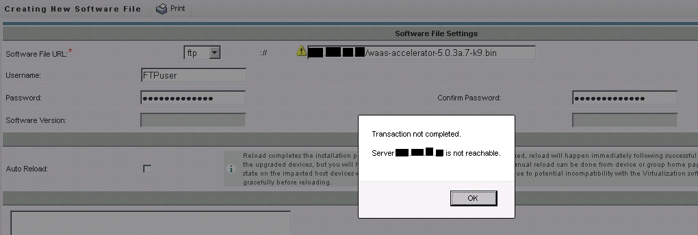

                   Hello Guys,
I have a problem with uploading iOS file to Central Manager for future upgrades. I don't understand why it is not working. I have no problems with copy from/on FTP via CLI, but when I want to upload iOS file to Software Files on CM via GUI, I get this message: "Transaction not completed. Server x.x.x.x is not reachable." See picture below.
Can you help please?

Hi Michal,
If it(ftp) is working from CLI i can only think of it as an issue with PASSIVE FTP. Browsers use passive FTP. Ensure that your server is configured correctly for passive ftp. If it is then it seems strange and i would suggest opening a TAC case to investigate further.
Have you tried any other browser?

Hi Kanwal,
Yes, I have tried another browser. Same result.
I have also created TAC case and I will post a solution, if I will find out something.
