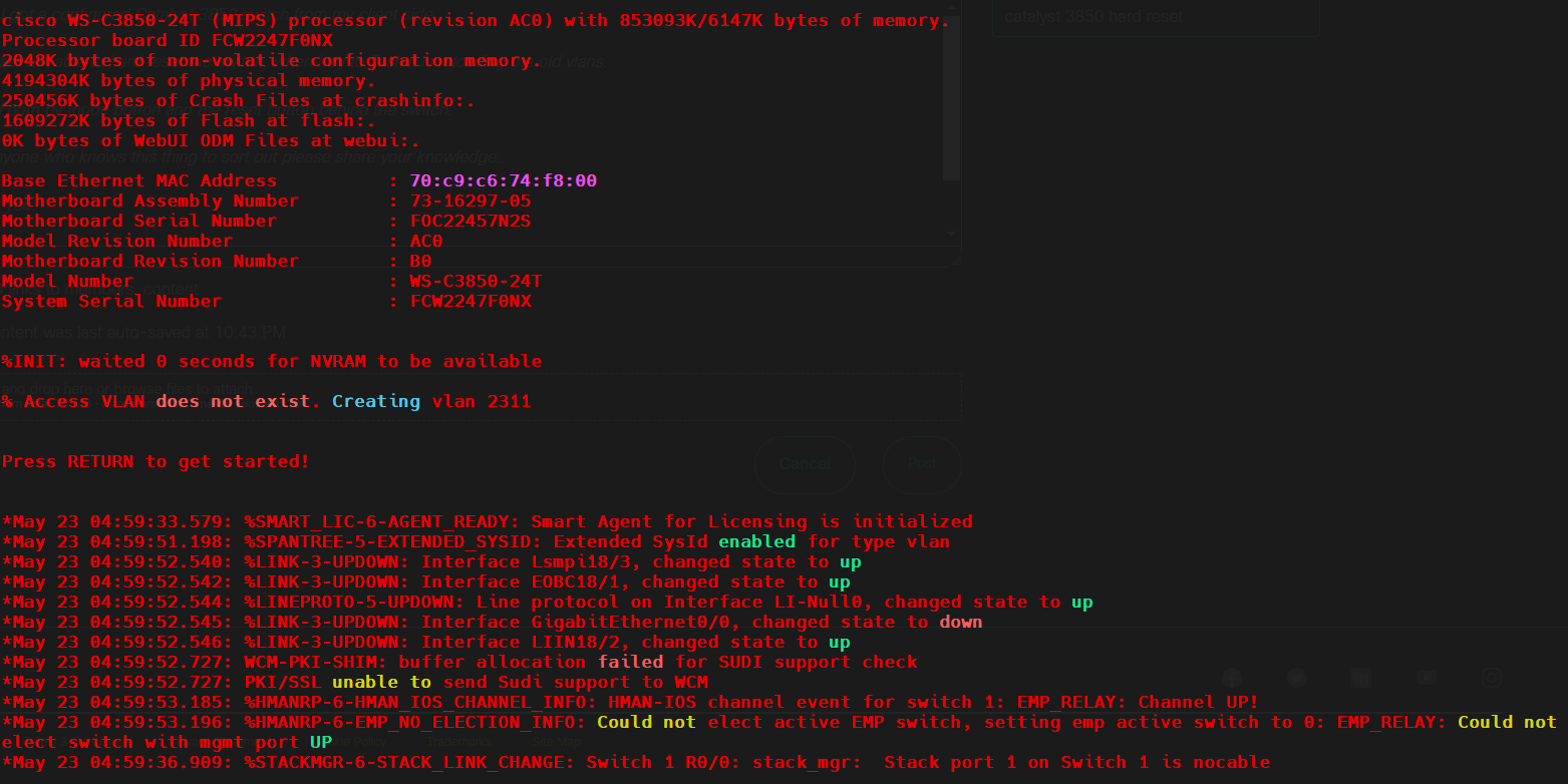

after pressing and holding the button for 45 sec the screen appeared like this
im not sure about which mode is this
From the switch:  prompt, run "boot flash:packages.conf"
yeah that changed the switch to factory reset .
