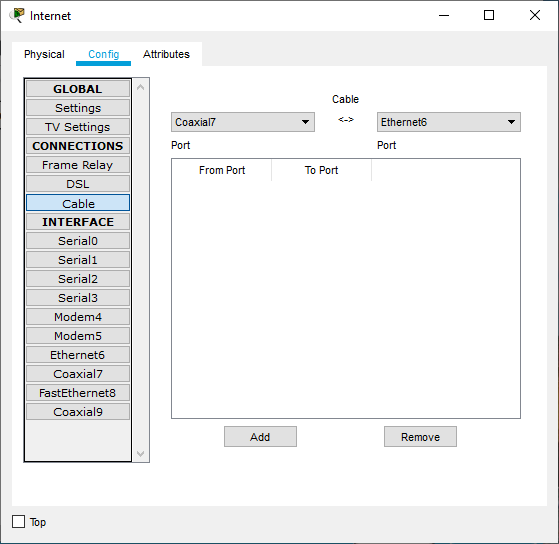

Hi!
First at all, I am not sure if this location is the best for my question, so sorry if it is not here.
I am doing the course "Introduction to Packet Tracer" in NetAcad and I need help.
I am traying to complete the point "2.1.1.5 Packet Tracer - Create a Simple Network Using Packet Tracer.pdf".
However I am not able to pass this part:
b. Identify the From and To Ports
Click on the Config tab in the Cloud device window. In the left pane click on Cable under CONNECTIONS. In the first drop down box choose Coaxial and in the second drop down box choose Ethernet then click the Add button to add these as the From Port and To Port as shown in the figure.
When I go to Cable in Config tab I can see Coaxial7 to be selected as From Port, but in the second box I don't see anything.
What is wrong? How can I get Ethernet interface in the second box?
Thanks!

I'm also facing this same issue. Who to rectify it .please help me.
ourmaninboston
I had the same issue, then seeing I could reach the default gateway, I knew it was something past that point. After that, I carefully combed through the instructions again. I'd missed one small step: clicking the "Add" button to add the cable to the ports on the internet cloud. As below:
As soon as I did that, everything worked fine. ;-)
