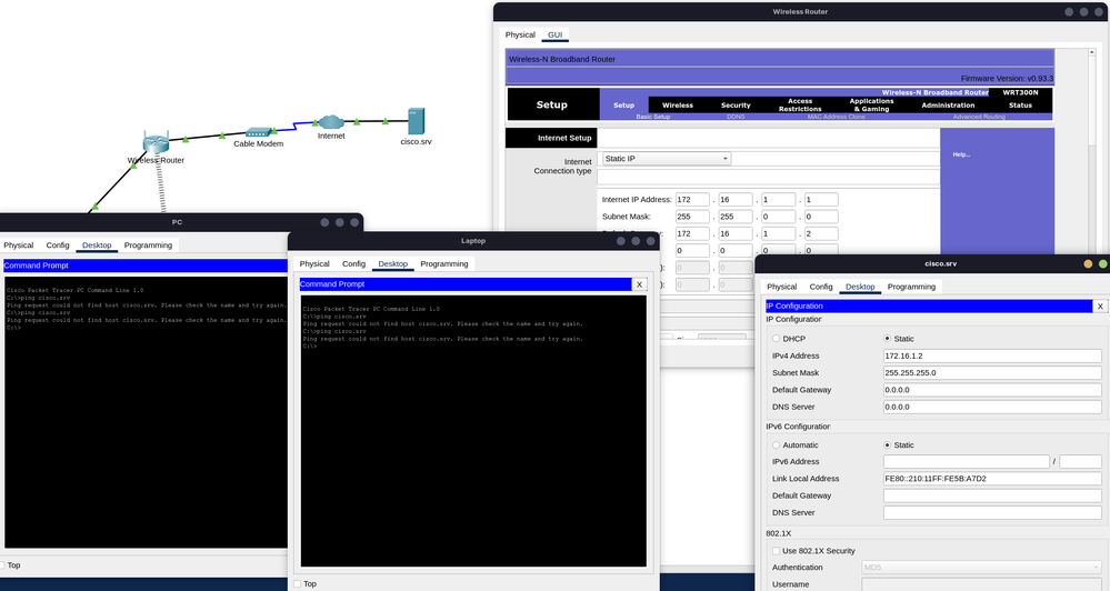

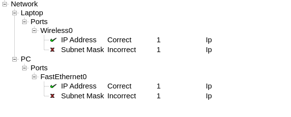

Hi there,
I can't finish this assessment as sub netmask is incorrect. I was looking at this post but non of this solution worked for me https://community.cisco.com/t5/cisco-software-discussions/2-1-1-5-packet-tracer-create-a-simple-network-using-packet/td-p/3762216
I spend to much time on it and I can't figure out what is wrong. Any hint welcome
Thanks!

 The instruction for the server part is missing.  But, if you add a static IP on the Wireless router and on the server, the PC is able to communication with the server.
  You do have end to end connectivity but it is not clear to me if that was the way to go on this.

You need to go to the wireless router, Internet interface, make it static, add some ip address:

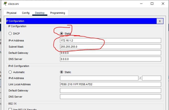

then, you go to the server, and change it to static and add Ip address:
This is it. Worked for me.
that's my settings.
You made a mistake on wireless  routers mask. It is not 255.255.0.0 , must be 255.255.255.0

ok, so I can ping server by IP 192.16.1.2 but I can't by the name cisco.srv so there is some issue with DNS. There is connection but now I have a problem with both subnet masks
You can change the mask to 255.255.0.0 is required, but you need to do it on both device:  Wireless router and Server.
If you change one side only, they will not ping anymore.
