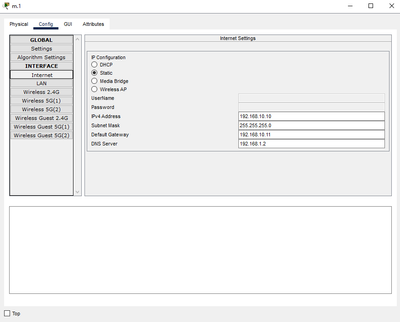

   Here Router - Each house has such a router, the IP differs
LAN HOUSE 1 - 192.168.3.1 HOUSE 2 - 192.168.4.1
 Internet DOM 1 - 192.168.10.10 192.168.10.11 DNS like Server, DOM 2 - 192.168.11.10 192.168.11.11 DNS like Server.
Konfiguracja routera - Internet.pngKonfiguracja routera - WireLess .pngKonfiguracja routera - LAN.png

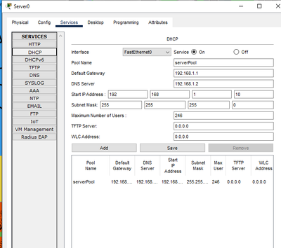

The first are photos of the server configuration:

I would like to know if I am doing this correctly, or I would like to ask for advice if I am doing something wrong.

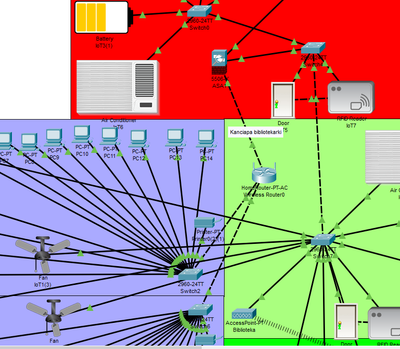

Last projects
The problem I see is the same. The firewall is not properly configured.  You need to enter on the interface and use the command nameif <something>
And add route. Use the files  I sent as examples.  You firewall is the center of you network, if you dont configure it properly, the network wont work.

It has already worked even in the dorm, you will look at the appearance of the dorm. Is it a good idea to set up access points in this way, and is it a good idea to set them on one channel and SSID to cover the entire campus?
No, it is not. Each AP must be in a different channel.  As those Access points only supports 2.4 Ghz,  you can use channel 1,6 and 11.
You can repeat channels but only if you have no alternative.
kapustamarianna
And what do you think about whether it could somehow be done better so that there are fewer switches and it looks neater? can some devices connect differently for security reasons?
You dont need 2 switch on the Red rectangle or you connect both to the Firewall instead. A switch has 24 or 48 ports each and it is ok use most of them. You can save by puting more device on the switch but you will also create a bigger failure point. So, in real world it depends how much money you are willing to expend.
