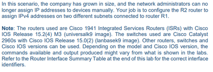

I am unsure if I am posting this in the right forum. If I am not, please advise me as to where I should post it. This is a frantic cry for help after the professor for my Network Defense and Countermeasures class decided to turn the class into a Cisco class, and give us an assignment requiring Packet Tracer. I have zero experience with Packet Tracer, and am trying to learn as I go. The following is the assignment itself.
