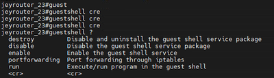

Hi M02@rt37,
Let me check on both platforms and revert to you.
On the ISR 1111, no such options :
Need to check on ISR4321

Ok @Jerems,
I'm afraid the command is not available.
Let me check also on my side.
Best regards
Jerems
Still not possible on isr 4321 nor isr1111 😉
