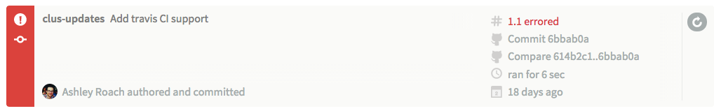

We check-in and push the .travis.yml file to github, and boom a build will now start in Travis CI.
The observant reader might ask, well, why is it build #5 you're showing?  Good question!  Turns out it took us 5 builds to get all the configuration right.
See, we all make mistakes!
