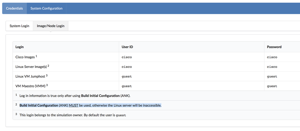

I've made a Virl Topology with 6 servers and got it all to work except I have no idea what the default User and Password is for these servers:

Got another cappuccino to wake up and I've seen now a nice note:
Build Initial Configuration (ANK) MUST be used, otherwise the Linux server will be inaccessible.
So the magical question is, how to activate this build ?
A quick first google and search on the forum did not help.
I did try all the user pass combi's I've could find on the VIRL info page and the DEVNET info page with user and pass.
I've build my own topology from scratch, this might be a important detail.
