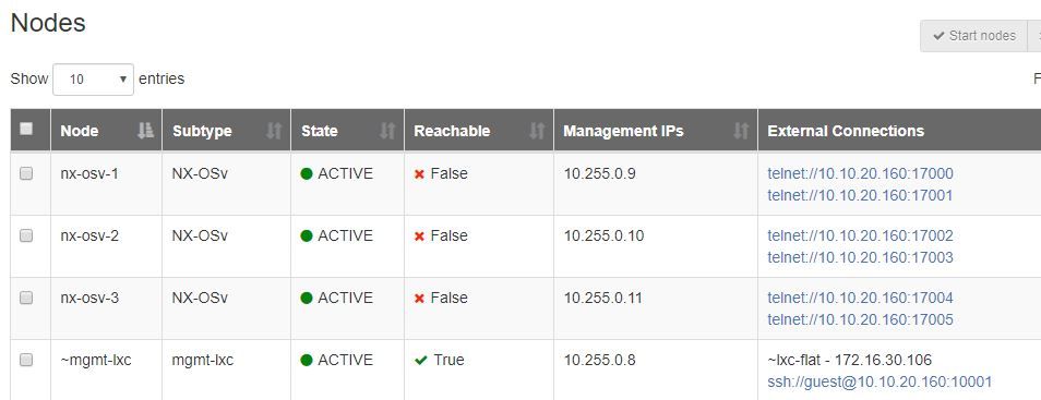

I think I'm missing something small yet significant. I'm running into the same issue (and actually took a step back tonight).
I created a basic topology with three routers. I never could figure out how to go back to the UWM page and display the nodes, so I resorted to a method that's worked consistently. That method is building the topology, downloading it, then re-launching that topolgy from the UWM page. When I do that, I see the node status:
But, as you can see, the nodes still show unreachable. And here's what I see from the jump server. You can see I'm in the directory with the topology.virl file and see my lab active and the nodes show Active, but once again, they're unreachable:
I am not running VIRL from my PC. I'm doing all of this strictly from the sandbox. The only thing I'm doing from my PC is connecting to my lab using AnyConnect and connecting the the virl server and DevBox/CentOS box using SecureCRT.
am able to access each node via the console port. But why can't I access them using the IPs above, or the IPs provided on the main sandbox page (below)? I can't ping any of the four IPs above (or four IPs below) from the VIRL server or jump server. Where do these 8 IPs come from and how am I supposed to be able to reach these?

Hey Andy,
Seeing unreachable, is a red herring, this was a known bug in older versions (one i saw often on this lab), i am not sure what causes the test to fail.
The IP address are created dynamically (unless other wise configured), you will see on your virl file
