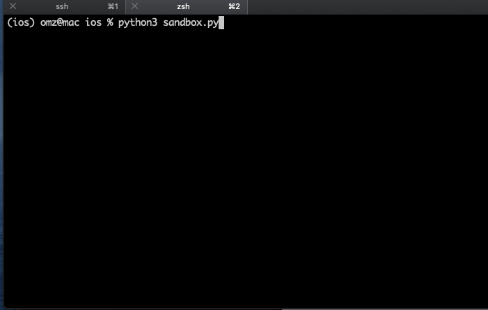

Hi
device_type="cisco_xr"
commands = ["logging history size 500", 'commit']
and it should work

omz
Hi
and it should work
Simple as that, maybe I should've read the documentation more. Thanks!
