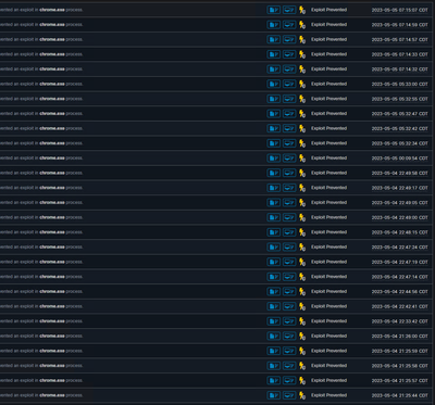

I have over 500 alerts for chrome.exe exploit prevention alerts on all different devices in Secure Endpoint the past couple of days.
All the same hash
55c3f36080f2ddbf4c47d6685fa42333ee0172866a31c0f29c1797dc2954ab29
I have added that hash to the allow list and it still blowing up.
Any ideas?
