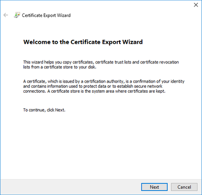

  • Certificate Export Wizard – click Next

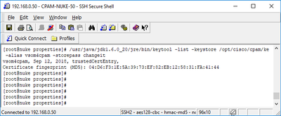

  1. Execute this command (replace vsom4cpam with your deployment’s hostname):
    /usr/java/jdk1.6.0_20/jre/bin/keytool -list -keystore /opt/cisco/cpam/keystores/truststore.jks -alias vsom4cpam -storepass changeit
    Screenshot from last command results

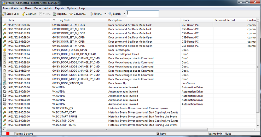

Note: Not all event log codes shown in the Report are used or even reported in ICPAM Events! Most, but not all, of GW.EV log codes reported via ICPAM Events will be reported externally, sometimes requiring double-checking on VSOM sensor log files to see what is transmitted as an event. However, to monitor what is actually logged in the Events window in the ICPAM application, you can add a LOG CODES column to the EVENTS windows (under Events & Alarms > Monitoring > Events).
Screenshot of Events with added “Log Code” column
In the screenshot above, log codes such as GW.EV_DOOR_MODE_CHANGED_BY_CMD, GW.EV_DOOR_FORCED_OPEN, and GW.EV_DOOR_FORCED_OPEN_CLEAR, and will be reported outbound from ICPAM for the door action – others will not.

The DOOR STATES communicated in ICPAM are identified by LOG CODES. You can see LOG CODES by adding a COLUMN to the EVENTS windows (under Events & Alarms > Monitoring > Events).
Default Events Panel
Adding a column – add a check box to Log Code
Events displaying log codes
In ICPAM access control application, typically the DOOR is the entity that you need to monitor. The door state of interest here would be the Door Forced Open or GW.EV_DOOR_FORCED_OPEN which is the state in VSOM that is going to be tracked. Earlier we had shown how to get the unique door ID.
