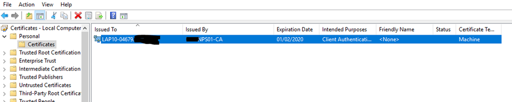

Based on your scenario it seems that you are failing dot1x and falling back to mab. Hence why you see the mac address as the hostname. Does your computer have a certificate to use for authentication? Are you using the Windows native supplicant or anyconnect?
Hi Mike,
I use the native supplicant on the windows 10 environment.  Yeah the device has a cert, as shown:
yet I am still getting the issue.  The CA is also the NPS server.

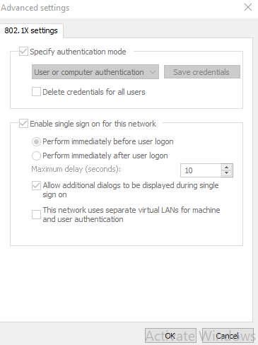

Is Wired Auto Config service running on the client? If so, please share the configs of your native supplicant.
Yeah the wired autoconfig service is set to automatic and started.
The details from the NIC are as follows:
I hope this is what you mean.
The RADIUS server is set up as follows:
Thanks for sharing. Please flip the 8021x settings to computer auth only under specify authentication mode and restart the authentication process. Please share outcome. Thanks
