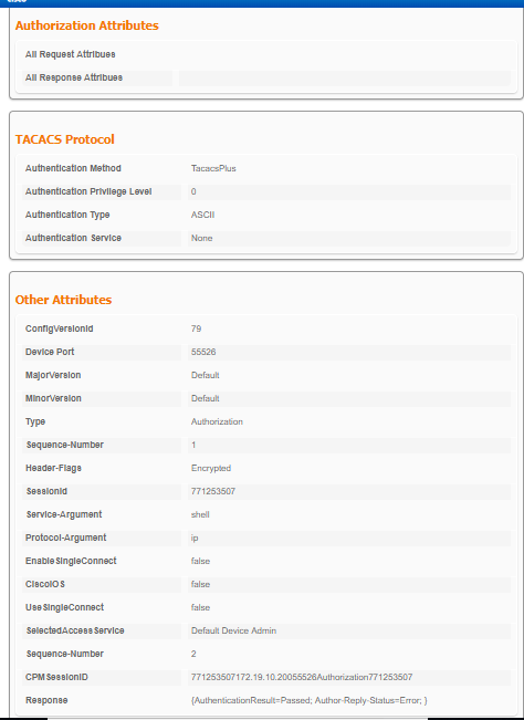

This is my Tacacs Live Log...

Now, for one of the ones you have without the policy, can you click on the details. Can you post the step data omitting any personal info. An example of mine is below. Do you see it hitting a permit rule?

ok, there are no hits on the rules, and it fails with an invalid request. Sounds like the switch is not sending the request correctly.
What is the switch you are using, what brand and model?
You may want to dry different device and TACACS modes under the ISE network devices.
