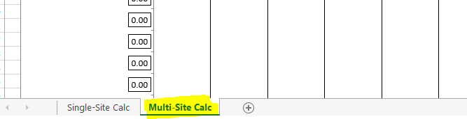

The customer has provided the number of endpoints per location with the primary ISE node at DC and secondary ISE node at DR location. Can this bandwidth calculator able to tell the BW used per location when they connect to the DC or DR site?
Is there any reference document for making use of the the bandwidth calculator for above scenario?
Select the Multi-Site Calc tab at the bottom of the screen for this functionality.
