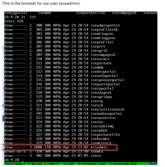

I booted up a centos rescue image and mounted the ISE disk to try to see what happens.
Looking at the /etc/passwd file I can see that our static user (acsadmin) has the UID 500
But the homedirectory is for some reason assigned to a user with UID 1000, and the same ownership is set for all files within the folder:
The UID 1000 is non-existing on the unix side of this deployment, and it prevents the user from changing its work directory to its homedir if I understand correctly.
I have TAC involved in troubleshooting, to find the reason why the update would change the ownership of the folder and content.
