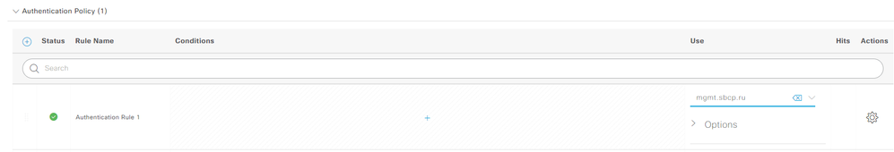

Ok, I realize that I should create Authentication policy with my LDAP "mgmt.sbcp.ru"
But when I try to save policy, the error has occurred.
What condition shoud I use in this policy?
Hi @fomin.v87 ,
 you need to configure at least one Condition.
Hope this helps !!!
