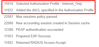

DACL is not applied well in ISE.
I configured dACL as above.
However, you can ping anywhere.
If you look at the log, it appears that dACL is applied.
What is the problem ??

Have you checked the status of the session on the switch? Are you sure the dACL has been downloaded?
The switch is not registered with ISE.
WLC-ISE environment.
I want to control clients with ACLs in a wireless environment.

Our controller is WLC5520.
Is it incorrect to use ISE dACL in ISE-WLC-AP configuration ??
I am currently importing WLC's ACL from ISE using the AirSpace_ACL function.
