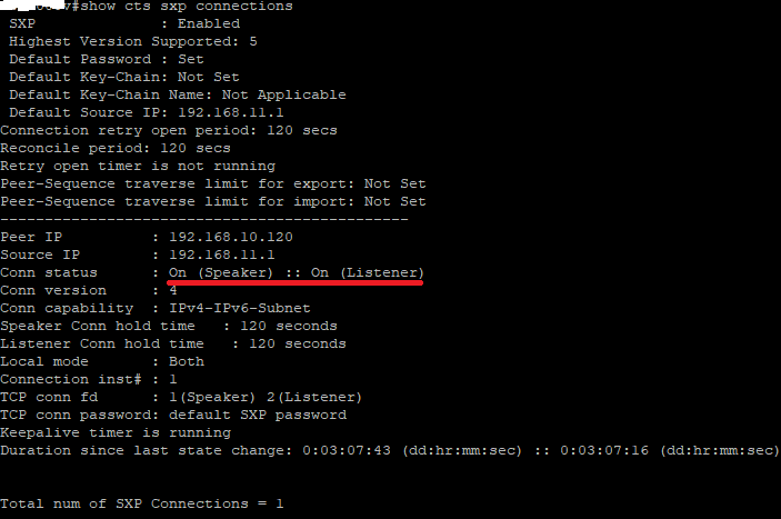

Recently, I decided to dedicate some time to revisiting TrustSec operations. To do this, I set up a lab environment using Cisco ISE 3.3 Patch 5 and a C8000v router running version 17.15.1a. I configured SXP between the devices, and they are communicating normally via SXP as expected:

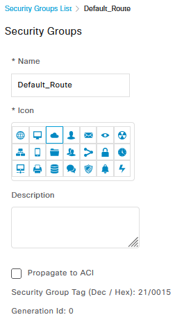

Then, I created a new SGT on ISE with the following parameters:
