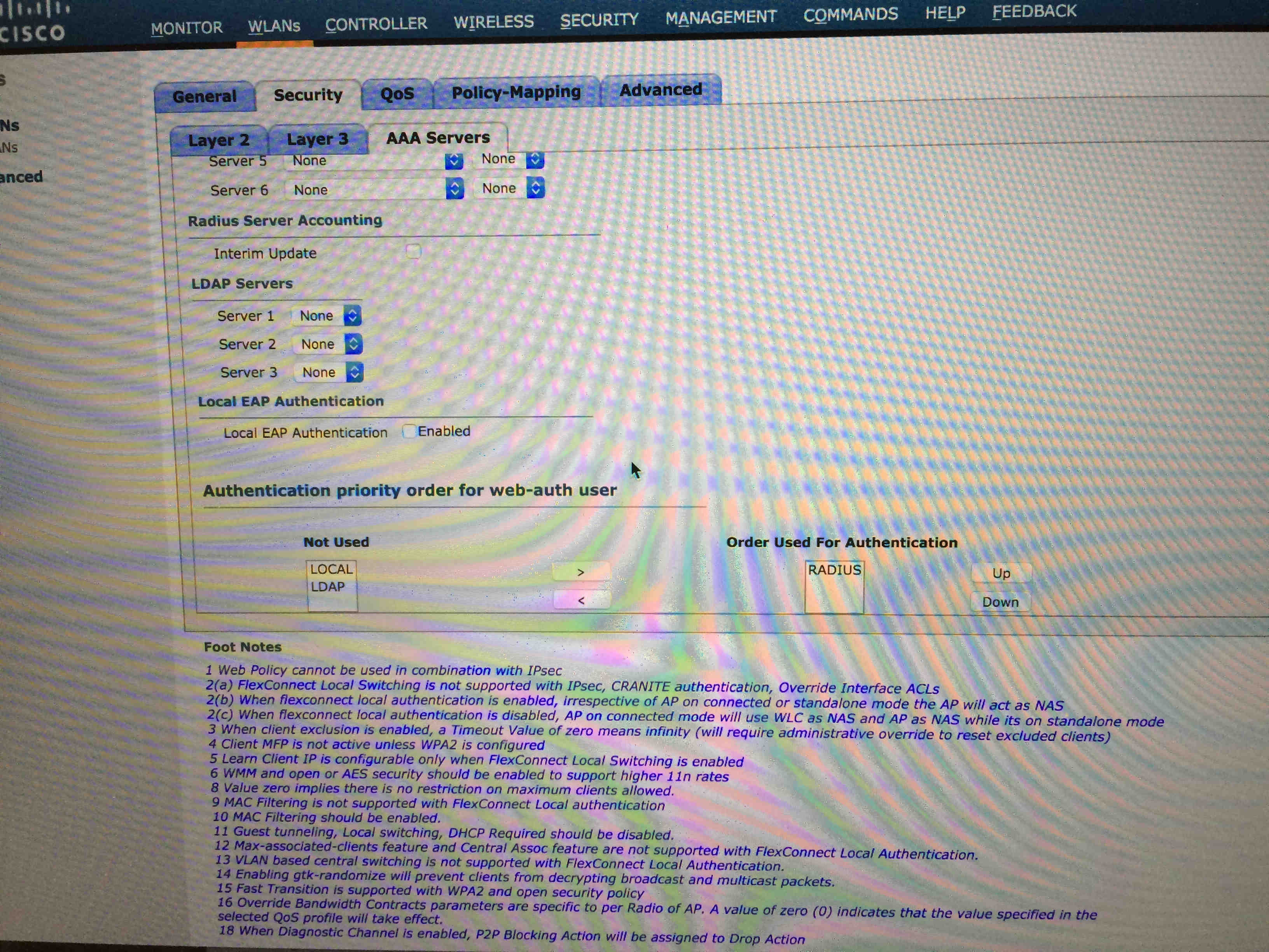

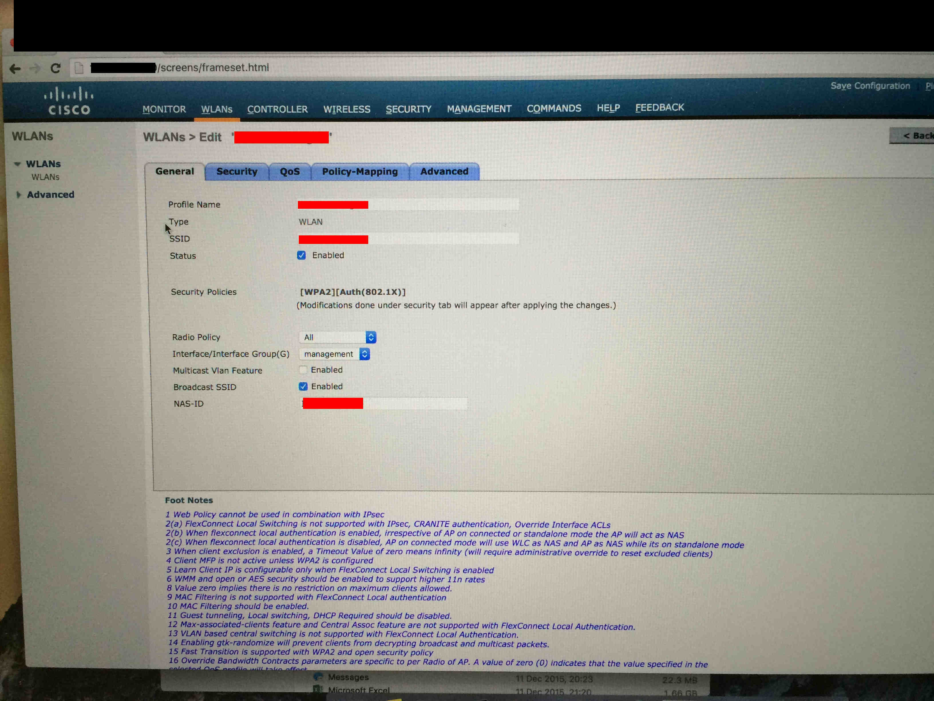

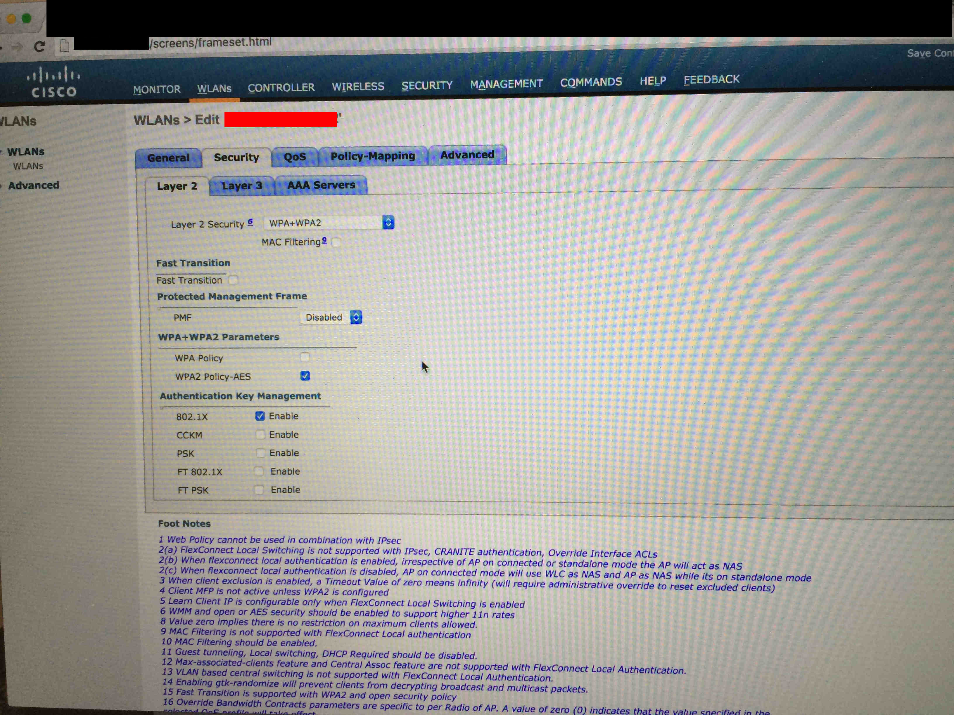

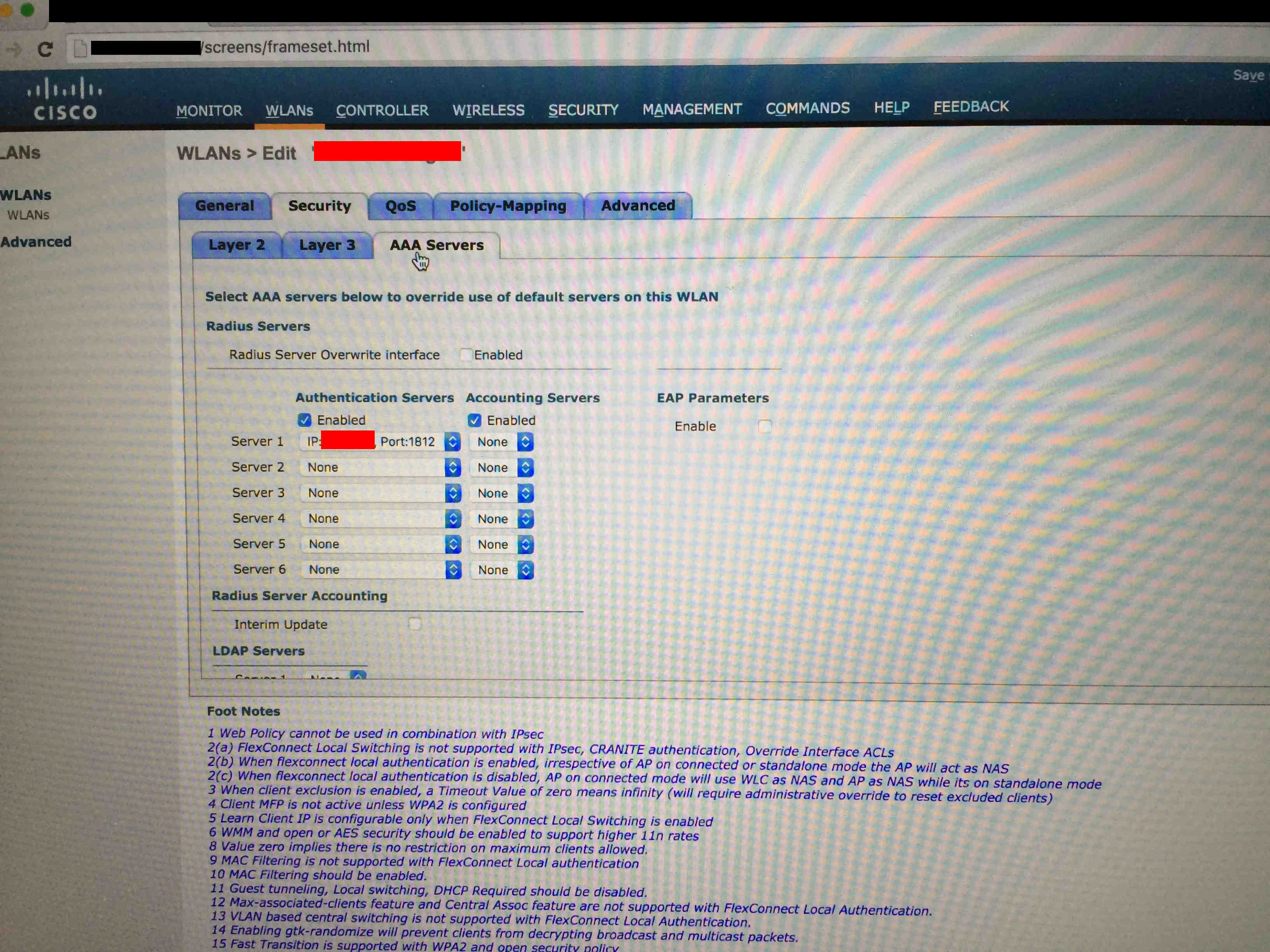

Hi All
We are attempting to configure a RADIUS server with a Cisco 2500 Series Wireless Controller (AIR-CT2504-K9). Below you can see the configuration of the RADIUS sever on the controller, with the correct IP:
Below is the configuration we have for the current WLAN when we try to attempt to connect it to the RADIUS server:
We know that this WLAN configuration works when not configured wit RADIUS (no AAA servers configured, only Layer 2). When trying to connect using a Windows Laptop or phone, the connection attempt times out. When attempting to connect a Macbook the  we receive a 'Failed to connect to authentication Server' error message. Below are the logs for an attempted authentication from a particular MAC address, in this case an iPhone 5s.

The logs on the RADIUS server indicate that no authentication attempts have been made when attemping using an iPhone or Macbook, while attemping connection using a windows laptop shows failed authentication logs using incorrect login details.
The RADIUS server is running on Windows Server 2008 R2 with setup from this guide:
http://www.cisco.com/c/en/us/support/docs/wireless/5500-series-wireless-controllers/115988-nps-wlc-config-000.html
Any help is greatly appreciated.
