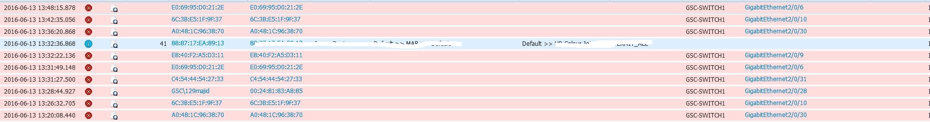

Dears,
attached is the error for dot1x.
I have configured dot1x and it is working fine with dell laptop as I tried with 2 or 3 users,,  but it doesn't work with  hp pc as it gives me the attached error.
when I left the office I have Google out and found the link https://supportforums.cisco.com/discussion/12451301/cisco-ise-changing-domain-user-doesnt-trigger-automatic-reauthentication ; now I want to know is it Suppress Anomalous Clients option is enabled by default ??? by unchecking that will the dot1x will work.
thanks

Hi Jack,
Please let me know which version of ISE you are using and do u created the ISE Authz policies based on device profile or only 802.1x attribute?
1. by looking at the screenshot I can see device is getting profiled as cisco device ?
2. u need to compare the policy for working device and non- working HP PC- as in screenshot shows device sending the authentication- MAB(Mac address bypass) method.
3. yes - by default radius suppress setting is enabled in ISE- you can verify in settings->protocol->Radius protocols-settings -it only applies to devices if Reject Request After Detection is enabled and policy will be in effect till the request rejection interval time specified-
share the details- will suggest the fix.

Dear Pradeepa,
I have configured MAB for HP printers which are detected by ISE as HP device so I gave them full permit now when I started to move the users HP PC's they are also seen as a HP device and they are also falling in MAB so to avoid such situation I disabled the Printer MAB policy for time being and try to restart the HP PC then as per the screenshot nothing was seen in  the authorization logs as per the attached this is becz of they have already been suppressed. please correct me,
how I can avoid HP pc to fall as HP device rather then they are capable of Dot1x.
thanks

Dear Pradeepa,
I have done the below still it falls as a HP device, In authorization rule I have a condition as domain computer and domain user but still
4. create autz policy based on 802.1x attribute and with the domain group-(users AD group) without any device profile.to overcome profiling issue,.
thanks

Dears,
I have disabled the above policy, still some of the PC are failing by error
5434 Endpoint conducted several failed authentications of the same scenario
I can see a mac address of the machine in the radius live logs instead of their hostname  for example host/HR-PC1 as an identity and it gives me the below error.
5434 endpoint conducted several failed authentications of the same scenario.
15039 rejected per authorization profile
Some of the PC were working fine with dot1x  but suddenly they started with this issue.
thanks

Hi Jack,
system is hitting the deny policy as there is no 802.1x request from the PC and there is MAB authz allowed for that devices- that is reason you are getting that error,
Do you configured MAB(Mac address bypass) authz policy for the windows devices? if yes please verify the policy.
Problem looks like with PC just verify the wiredautoconfig service is running in PC? there are no certificate related errors?
as you said some of the PC's are working then it clearly indicate problem with system not ISE,

Dear
thanks for the reply, I appreciate,
yes I have configured mab for hp printers and not for HP pc's becz they are dot1x capable, my MAB policy was on top and dot1x was below that so all Hp pc were hitting MAB then I twick the MAB policy below dot1x and all PC started hitting dot1x policy, when I start to move the pc switch port configuration in dot1x they were successfully authenticating, for pc A I configured the switch port in dot1 and it authenticate successfully , the next day when I came the same pc gave me an error
why that so it is happening , before migrating the switch configuration I want to confirm the error is related to PC or misconfiguration on ISE
yes it is running and the PC NIC configuration are as the below link. please confirm that I am on the correct path.
thanks
