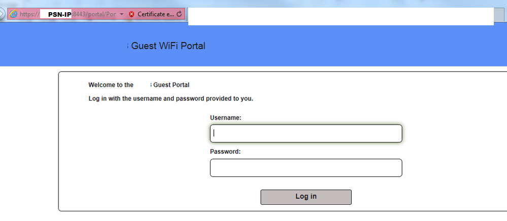

If you are accessing the guest portal from here (see below), the URL points to ANY of the PSN in the deployment so the opened browser shows something like:
https://PSN-IP:8443/portal/PortalSetup.action?portal=10be2e90-8001-11e5-b027-3440b5d4e810

I try to do the Portal test URL,it shows me the Portal URL from secondary ISE and i can not open the web site, i got "the website is not connected". User can just use the Portal URL from Primary. the both Portal URL were working before, now just the Primary, that confuse me.

Copy the URL from the displayed browser when you clicked TEST URL button in the Guest Portal and change the IP by the Secondary one and post the results. I am still waiting an screenshot from your deployment.
