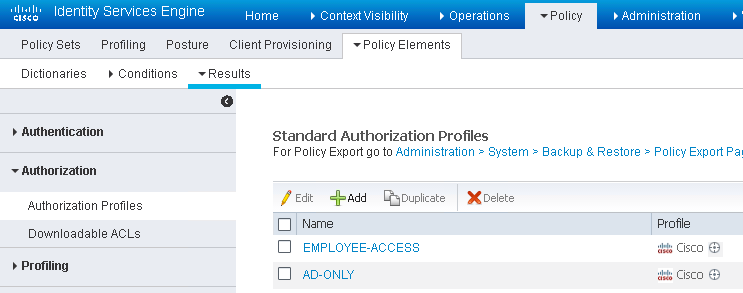

This is a good question.  I think that if you have implemented machine authentication (AD Domain Joined Machines), you should be able to do this.
I have an Authorization Compound Condition (Policy > Policy Elements > Conditions > Authorization > Compound Conditions) set up like this:
Which is used in my Wired Access Policy Set (Policy > Policy Sets)

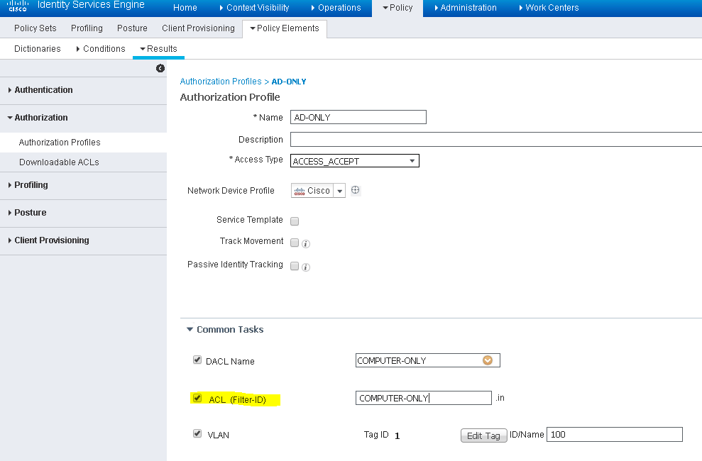

The permissions (AD-ONLY) given are set at Policy > Policy Elements > Results > Authorization Profiles.  Of course, you'll need a DACL for this, too (Policy > Policy Elements > Results > Downloadable ACLs).
And that should give you the access you desire.
This works great on Cisco switches, but not on HP ProCurve which this customer has. cant do dacl
Then reference the ACL on the switch:
