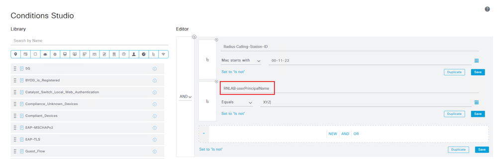

Okay. How do i then use that attribute as a condition in an authorization policy?
Edit/create the Rule, and then click on the Conditions field to open up the Editor
You can search in the AD Join Points. Under the Dictionary drop-down, look for you AD Join Point name - e.g.
