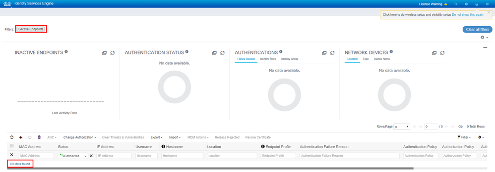

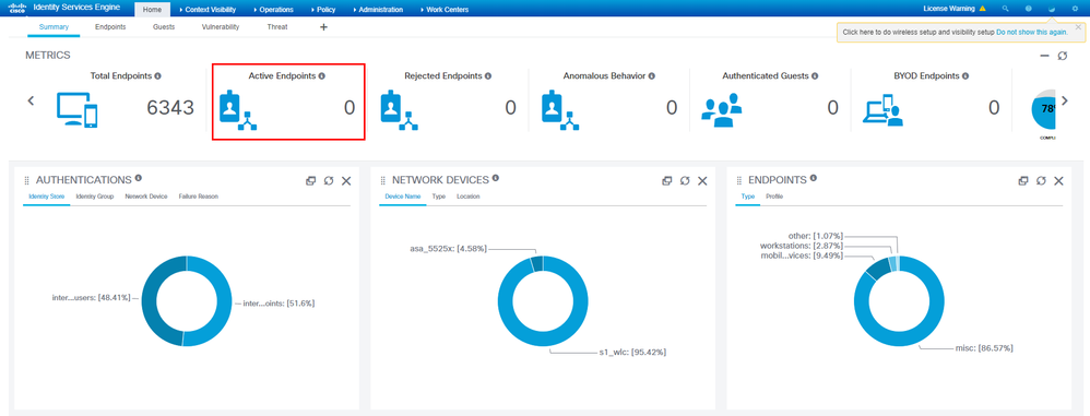

In ISE, the Active Endpoint count is 0.
Active Endpoint is displayed as No data found.
The Status of the Context Visibility > Endpoint shows nothing.
And the Network Device is also marked as No data found.
But actually, there is a Network Device.
On the Reporting > Radius Accounting page, many users receive wireless certification without any problems.
There seems to be nothing out of the ordinary in Live Session.

I'm no TAC engineer.  But in my experience when Context Visibility is not showing the correct information, TAC will ask you to reset and sync the context visibility data base through the CLI.  Just google search Reset Context Visibility DB you'll find their instructions pretty easily.
