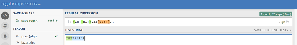

Thanks for the tip.  I think my regex is a bit rusty after all 😞
I should have gone to regex101.com and tested my expression before posting.  Sorry about that.
My initial expression was this one below and I thought it should have worked in ISE.  I will try again
But I miscalculated on this one ... this is not going to work at all -
As Hsing stated correctly, I'd have to use something like
