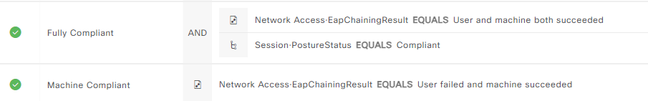

We have successfully deployed the TEAP policy using Cisco's documentation .   The challenge seems to be that the Machine Compliant policy is the only hit we are getting.  Never hits the Fully Compliant policy.

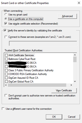

  • Windows supplicant is provisioned as per documentation to use EAP-TLS for both primary and  secondary EAP methods.
  • Both computer and user root cert providers are the same
  • User certificate is provisioned for "Client Authentication" and located in the Personal->Cert store on the workstation

You are using a Posture compliant condition in the rule (this is not a requirement for TEAP), I assume the device has actually passed the posture compliance check without problem?

Yes, posture is working ok.

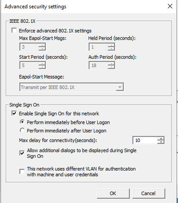

I would suggest the supplicant is misconfigured, please provide screenshots of how the windows supplicant is configured.
