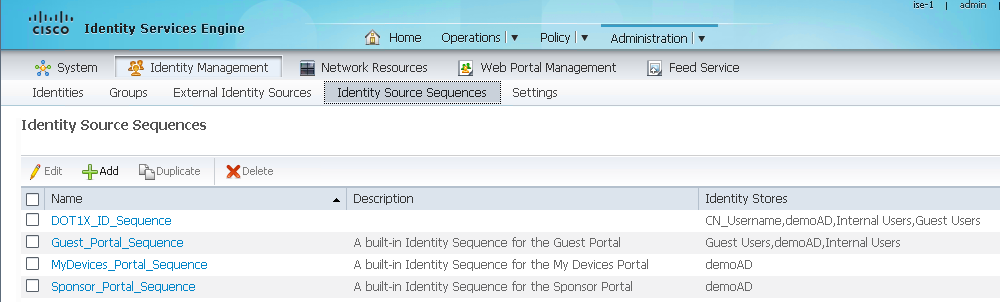

Once this is done, create an new Identity Source Sequence for each Guest type:
Then go to Administration > Web Portal Management > Settings and choose the Guest Portal you want to modify.  Click The Authentication tab and choose the Identity Store Sequence you just created for that portal.
That should fix the issue.
