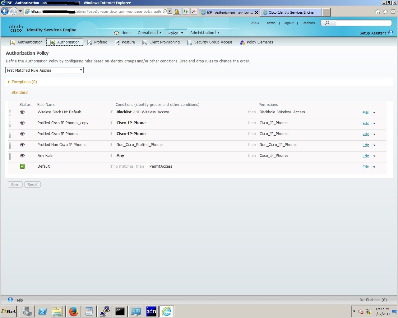

I have a number of Cisco IP phones profiled by DHCP probe and sitting in the Endpoint Identity Group "Cisco-IP-Phone" (dynamic not static).
However when this is used in an Authorization Policy it never matches.
Just a basic Policy:
if Cisco-IP-Phone (no conditions) then Cisco_IP_Phones ......no match.
I can change Identity group to ANY and it works.
Sure i must be misssing something but I've gone round and round with this.
Tried deleting enpoints and allowing them to repopulate....failed.
Tried changing endpoints to static with no luck.
Noticed the "Cisco-IP-Phone" group is under the "Profiled" group so tried using that in the policy....no change.
Whatever i've tried just ends with the Authz going to the "Default" policy.

Hi Sorry for the delay.
Can't get access to the access switch at the moment but all is reported as being ok. dot1x authentication  in data domain (no voice vlan in use).
I've attached some screens from the ISE.
01 shows phones picked up by profiler (dhcp).
02 shows phones profiled into "cisco-ip-phone" group.
03 is the authentication policy in use.
04 is the authorization policy (all except default set to monitor)
05 is the authn/authz completing.
06 is details for the phone mac ending 5490. To my eye shows the "any" policy firing on monitor and succeding on the "default"?
11, 12 and 13 are the same again except with all the authz policies enabled. 13 just seems to show the "any" rule succeding as expected.
Still cannot understand why the "Cisco-IP-Phone" group is just bypassing? Especially as these are just the default rules that already exist in the ISE out of the box!
