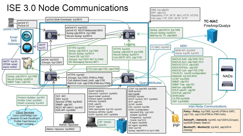

Hi @mothukuri
 yes, the link is Cisco ISE 3.4 Port Reference, and you should check the Cisco ISE All Persona Nodes Ports topic for Node communication.
 Also take a look at Cisco ISE 3.0 Installation Guide, special attention to Cisco ISE 3.0 Node Communications:
Hope this helps !!!
